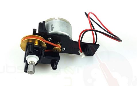

Messagepar Jean-benoit » Sam 2 Sep 2017 16:13
Merci glnc222 pour toutes ces infos.
La mécanique des brosses latérales pour les VR100 est vendue en Allemagne pour 60€.
Moteur brosse latérale VR100.JPG (22.58 Kio) Vu 4972 fois
Il y a peut-être des solutions moins couteuses ( imprimantes 3D) pour faire le support...
Le moteur semble être identique à celui du laser (exemple RF-500TB-12560)
A suivre ....

Messagepar glnc222 » Dim 3 Sep 2017 21:36
You may find that the internal structure of the VR100 is a little different on the side to make room for that motor assembly.
The lidar motor is also operated with PWM control, so how you would add it to the Neato without the needed circuitry is not clear.
On Rev64 Binky system boards, the SetConfig command over USB might be able to enable components on the board for connecting the VR100 brush motor, but the connection is not known (there was an unused plug on older boards, not sure about this one; they cleaned up left overs). It is possible Vorwerk populates empty spots on the Neato boards with extra components for the side brush, including a plug, unknown.
A motor drive circuit could be made with a 555 oscillator component. Correct voltage is also needed.
The price of that Vorwerk assembly from spare parts is high for use on a very old XV bot -- which might wear out any time.
If you get this to work I will add it to the old robotreviews thread; thanks for the Vorwerk pic.
