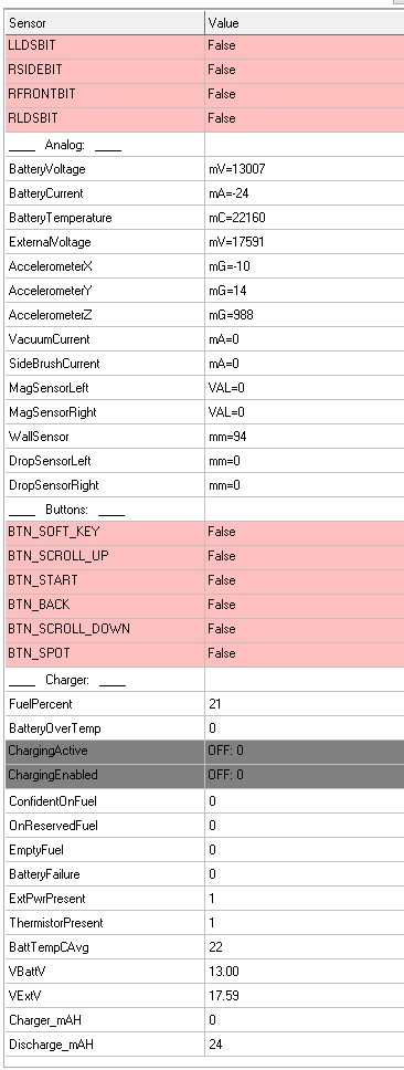

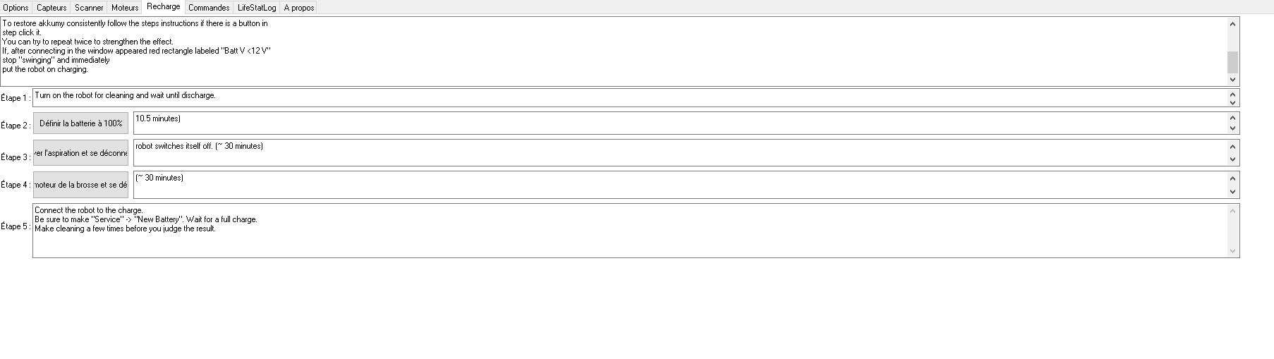

j'ai branché le programme néato et fait quelque capture d'écran avec sa batterie à zéro et le robot en charge après l'avoir éteins et allumé
[attachment=4]
[attachment=3]

The Neato Control data shows a battery which is mostly fully charged, at 13v. The Botvac is a nominal 12v system. The charging current shown is virtually zero so the system is not charging, perhaps because the system thinks the battery is fully charged.
Replacing the battery is required to diagnose almost any problem in such systems as there must be a known good battery; power supply problems create many different failures.

When replacing the battery there is an option in the LCD display for "new battery". This option resets a mathematical model of the battery condition maintained by the firmware. One possibility is that this model became inaccurate for some reason giving the computer false indications of when to charge. The only part of this model displayed over USB is the Fuel Gauge Per Cent full, which is not shown in the selection above. The parameter can be manually set over USB. Perhaps setting this figure to zero would initiate charging and recalibration of the battery. The Neato will monitor the battery for premature discharge, loss of capacity, and reduce the programmed run time accordingly to insure return to base. New Battery resets this monitor.
