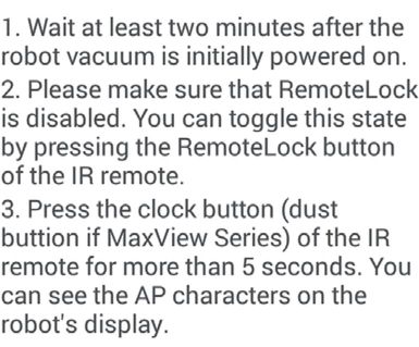

je possède ce robot depuis quelques semaines mais je n'arrive pas à utiliser l'application "smart home",pour authentufier le robot en 4 )on me demande " d'appuyer sur le bouton d'acceuil et d'aller dans réglages " et il ne se passe rien
essayé plusieurs fois sans résultats
merci de votre aide

I have a 9250 with WiFi connected to SmartHome android app.
If you swipe at the top of the home screen another page with settings and options appears.
In Settings there is "add a device" to register the robot.
Check Youtube for any videos.
Not sure this can help. It is also possible for Samsung's server to be out or over-loaded.
When setting up the smartphone talks to the robot directly to enter the router password. Then everything goes through the router. Samsung's server is not always used. Smartphone must be near the robot when setting up, to get a connection directly.
Follow directions in the robot manual. The 9250 manual was good. The router must be setup to meet the specifications, using DHCP etc.
On the 9250, pressing the Clock setting key on the remote several seconds shows "AP" (for app) on the robot, indicating it is talking to the smartphone directly to get a router password.

Which step in the instructions did not work? Did you set the robot into register mode with the Remote, and see AP in the display? This is to receive the password for the router. Was the phone on WiFi connected to the router?

Tu essayes de le connecter sur Android ou sur IOS ?
Tu as bien mis le robot en mode AP ?

Sur Android, l'appli le détecte bien mais c'est juste après le moment où je rentre l'identifiant et le MDP du routeur que cela plante.
Le mode AP s’éteint et rien ne se passe.

Possibly the router or phone is not set to the communications options specified in the Samsung manual, protocols and encryption password etc.
The phone should be near the robot to insure connection in AP mode talking directly to the phone, to receive the password for the router.

En fait le mien vient de me faire la même misère, suite à une panne de ma box il s'est désynchro et impossible d'aller au bout de la manip (bloqué au niveau de la dernière étape, connexion avec le serveur), la solution a été de l'éteindre via le bouton d’arrêt d'urgence (en dessous), de le laisser pendant 15 secondes, de le rallumer et ensuite ça fonctionnait
et comme dit précédemment, laisse ton téléphone ou tablette à proximité.
