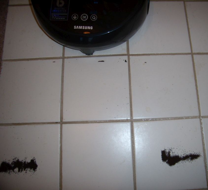

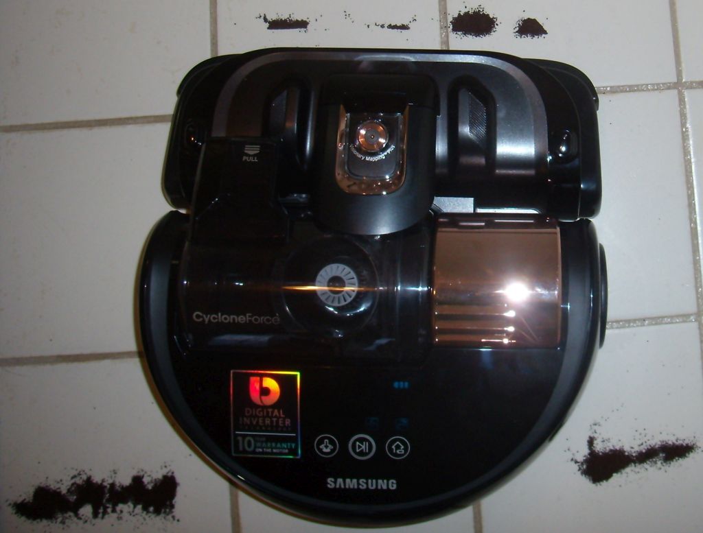

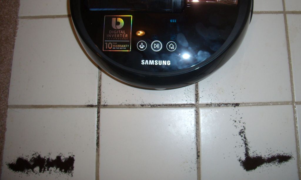

[b]Tests d'aspiration avec brosse enlevée VR9200[/b]
Révèle aspiration est efficace en plus de la brosse. Filtre mouture de café.
Brushless, Max Power Mode
Brushless, Normal Power Mode
Brushless, Quiet Power Mode (coffee hidden under front)

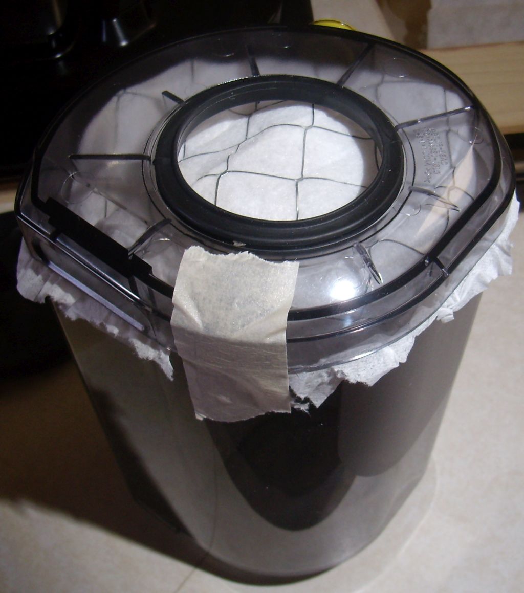

Re: Samsung POWERbot VR9000
Messagepar glnc222 » Lun 11 Jan 2016 02:58

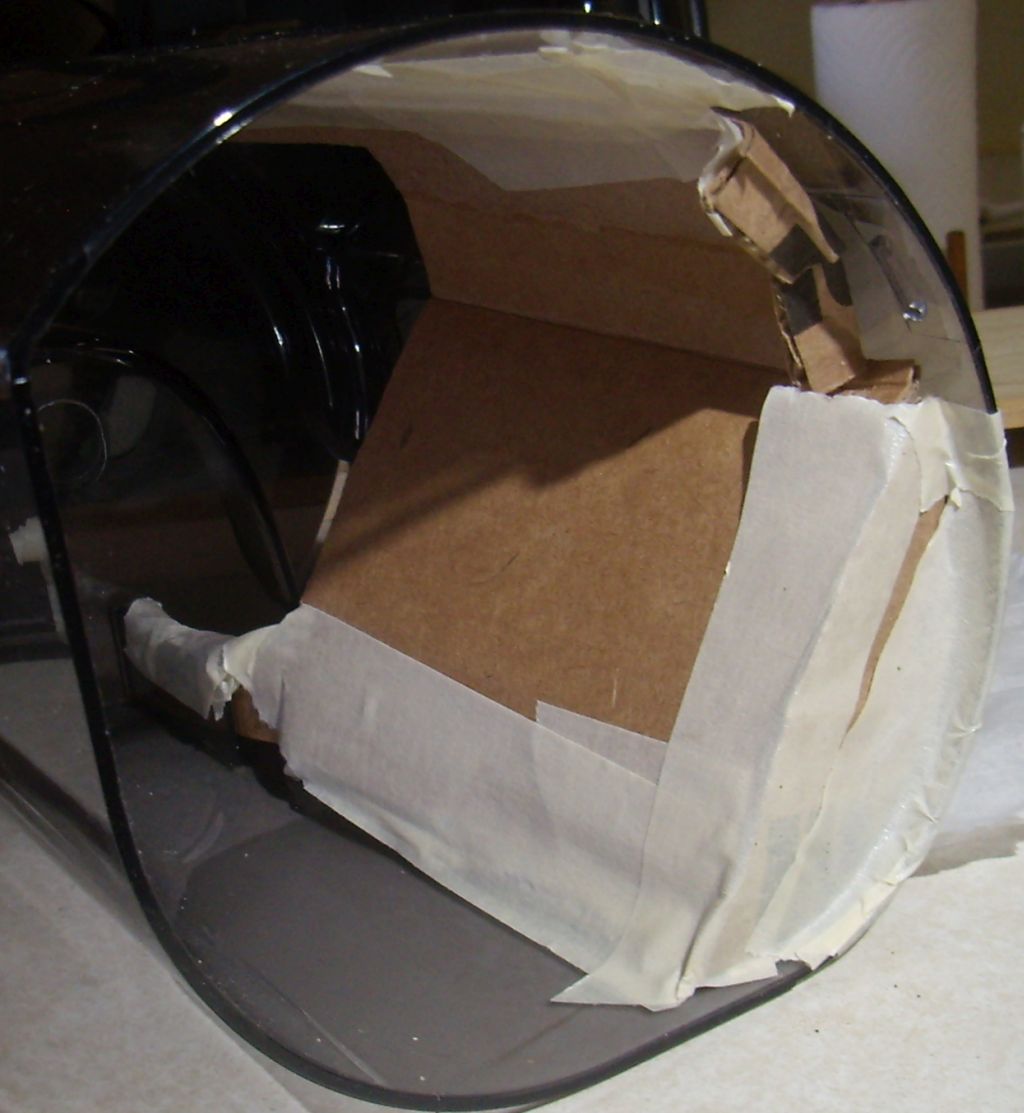

[b]Air Flow Reduced by Cyclone[/b]
The cyclone cup can be removed and the bin installed without it.
Removing the cyclone increases air flow 38 per cent.
A single ply tissue can be placed in front of the filter in this case, similar to Neato usage.
Furnace filter material could also be used in place of the washable filter.
Air flow will fall during runs as dirt accumulates against the filter. The cyclone prevents this at a cost in cleaning power.
Further tests will be conducted.

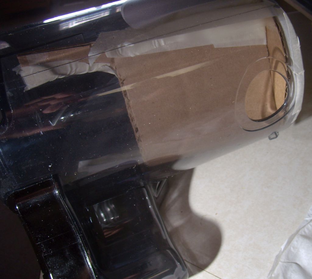

Messagepar glnc222 » Mar 12 Jan 2016 04:04
Replace cyclone with baffle for better fill pattern without cyclone.
[b]increase air flow 1/3. VR9050 up to VR9200 max mode with cyclone[/b]
Paper masking tape easy removal.
Alternate 3M Filtrete furnace filter with single ply tissue. Supplied sponge also good.
Increased air flow may reduce run time a little.

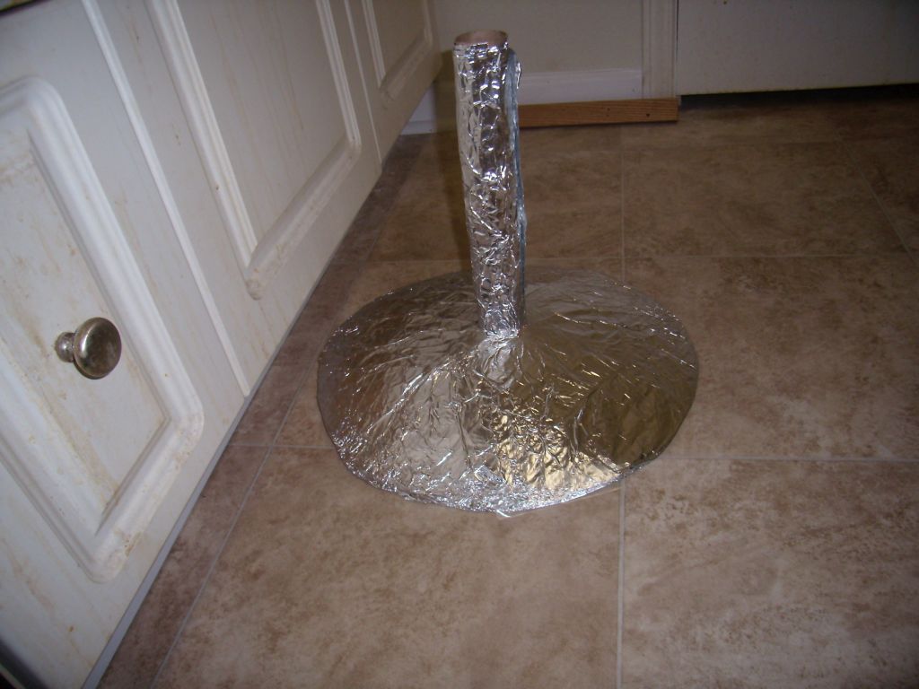

[b]chaise de bar[/b]
The Powerbot was not trapped on a model of the chrome bar stools which are a problem with Botvac (see taborets de bar etc. [url]http://www.kelrobot.fr/forum/post17067.html?hilit=chaises%20de%20bar#p17067[/url]). The larger wheels may play a role. The reflective surface does defeat the IR proximity sensors. The Powerbot just rolls on and off the base.
Soup bowl under 16 inch cardboard cone covered with aluminum foil.

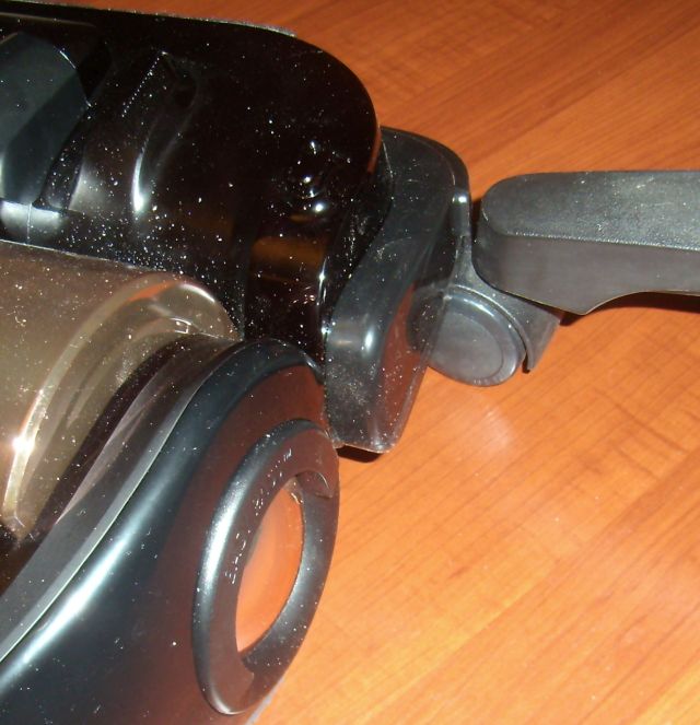

Messagepar glnc222 » Lun 8 Fév 2016 01:34
[b]Roulette PIège[/b]
Coin avant soulevé sur un lanceur de chaise piège le Powerbot. Logiciel arrête au lieu de tirer en arrière. Piège provoquent l'arrêt pour économiser la batterie sans surveillance. Le séjour de Neato sur batterie et de vidange. Neato et le Roomba ne se retrouvent piégés ici. Capteur faible dans les coins de PowerBot. Mettez toutes les roulettes vers l'intérieur sur des chaises.

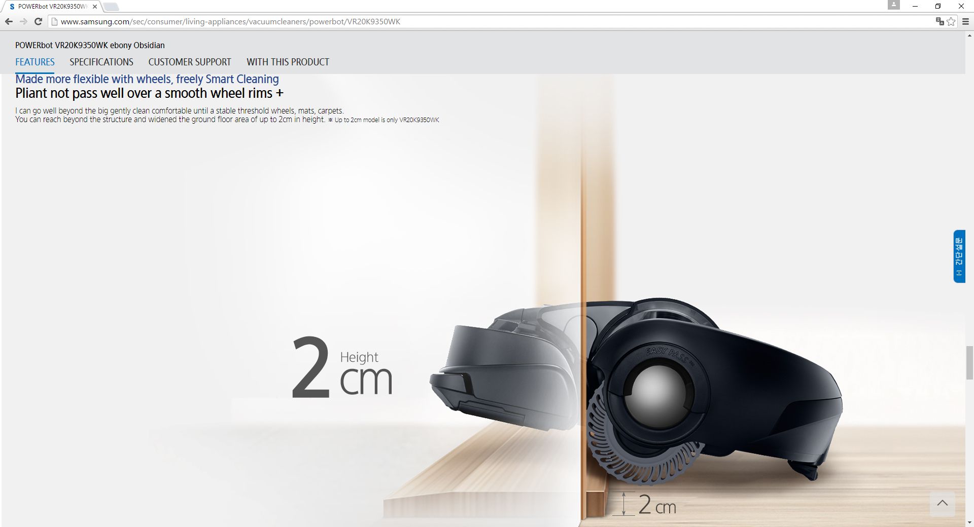

Messagepar glnc222 » Ven 15 Avr 2016 18:25
[b]2016 model VR9350[/b]
The 9300 announced at CES January 2016 is now listed at the Korean Samsung website. Google Chrome browser translates. One improvement is increased height of thresholds crossed to 2cm. Previously the IR sensors would stop at thresholds 1.3cm high. The change appears to be entirely software.
Additional software changes include three pass cleaning of corners and selecting rooms in the smartphone app.
