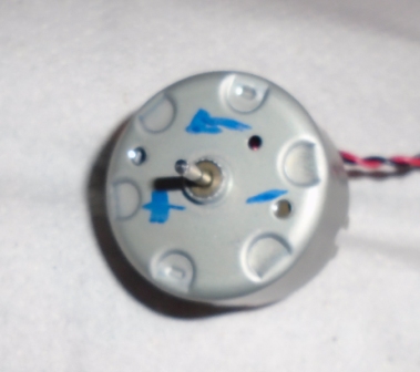

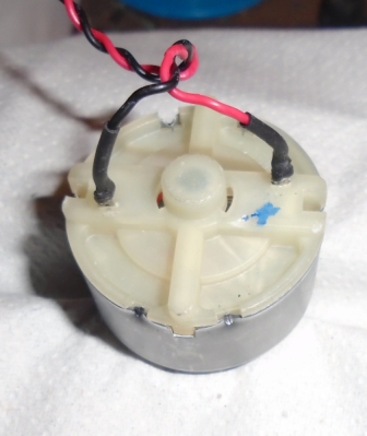

Messagepar Jean-benoit » Mar 1 Oct 2019 18:53
Voila la connexion du moteur
Sens de rotation nouveau moteur.JPG (63.68 Kio) Vu 3274 fois
Soudure alim nouv moteur.JPG (77.16 Kio) Vu 3274 fois

The lidar should spin counter clockwise. When replacing the motor, sometimes the wires must be reversed from the original. Polarity determines the spin direction. Test with the Neato Control Program to see lidar scan. Try the wiring both ways.
Other parts of the lidar can also be defective.
